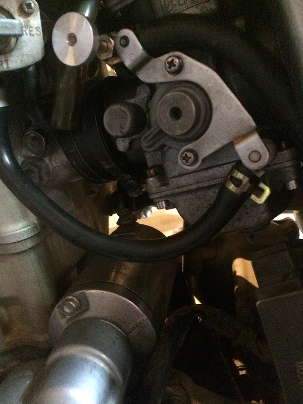

My poor DR Z got the Kawasaki disease! I got a Ebay KLR650 carb and tuned it for my bike. I got the carb for $90 shipped and, the parts added up to $80. I used Pine Sol to clean it. This was a waaaay cheaper option than the $600 FCR carbs. Wow, what a difference in power! It makes a lot more top end and mid range power. The decel on the down shifts are far less dramatic, engine runs cooler and, fuel economy is 50 mpg. I also have a bunch of 150 main jets for anyone interested. A pack costs $2 more than just 1. I'll give you one for free, if you want one. I highly recommend this big carb option!
