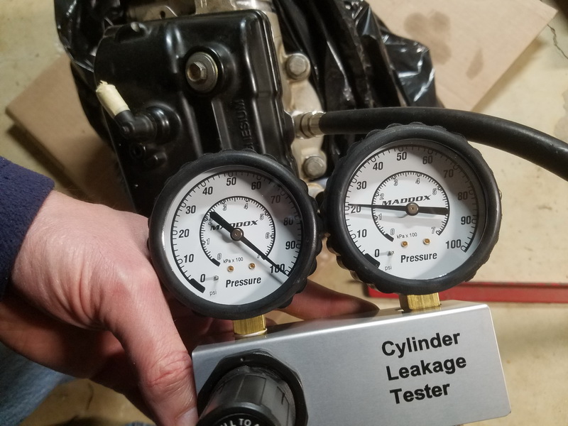

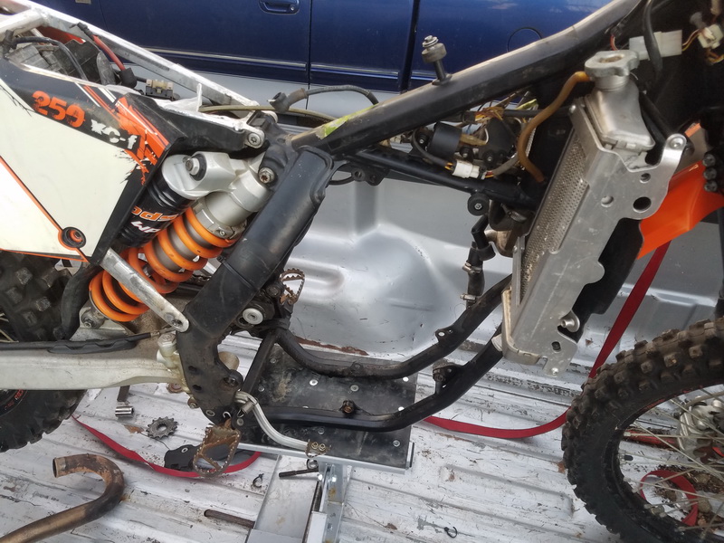

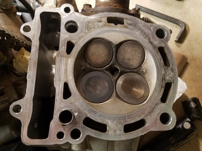

Picked up a 2009 250 XC-F project w/ a leakdown problem last week (rusted seats seem to be the culprit.) This is my first time pulling a bike motor out or apart. Is it *SO EASY* compared to cars! Everything is so small and light. Pulled the motor before I even unloaded it from the truck. :cheers:

I tried a leak down on my 600 and when putting the 100lbs to it, had a hard time to keep it at TDC. Dangerous! Is there a trick to holding TDC?

KTMs have a flywheel holding bolt that is installed on the bike. Factory, there is a thick washer/spacer under the bolt. You just move to TDC, remove the bolt, remove the spacer, and reinstall the bolt. It must go into a hole in the flywheel or something. But with 80% leakdown I couldn't develop enough pressure to really even test the bolt :lol2: Will give it a proper workout once the top end is repaired and I retest.
